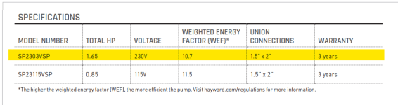

The performance curve matches the SP2307X10 pump which is a 1.25 hp pump.
The power use seems more consistent with the 0.95 total hp pump.
Also, the 1.65 HP and the 0.85 HP have almost identical performance curves, which is strange.
Maybe they both use the SPX2707CM Impeller?
Maybe check your impeller to see which one you have.
