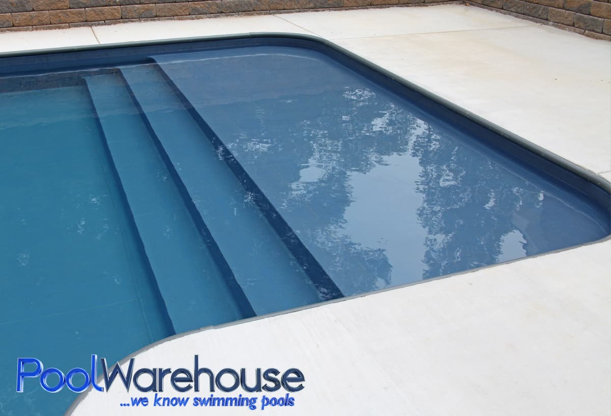

If you are doing vinyl over stairs, which you should, then look for an option like this for a more affordable tanning ledge that does not require the FB insert. These should be possible with perhaps $5K or less.
https://encrypted-tbn0.gstatic.com/images?q=tbn:ANd9GcRF_qsIhhfEcOcdK8aPQCtK817g1WzziLzQHQ&usqp=CAU
https://www.poolwarehouse.com/wp-content/uploads/2019/02/Miller-Family-Pool-05.jpg
