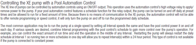

I have a Hayward Tristar XE (Model: SP3215X20XE) and an Omnilogic controller. Pool builder set it up as a single speed pump within the configuration wizard on the Omni, but it looks like pump is a VSP. I'm currently operating the pump 12 hours daily based on the schedule within the Omni app, although I'm not sure what speed the pump is running. I'd like to get feedback on how to optimize setup:
- Can this pump be setup as a VSP in the Omnilogic to control pump speed? I cant find any reference to omni setup in the owners manual
- If I cant use the Omni app, should I setup the 3 intervals outlined in the owners manual (Interval 1 - 4 Hrs; Interval 2: 8 Hrs; Interval 3: 12 Hrs)? The owners manual has 6 speed settings, what % and duration would you recommend I run the pump at?
- How would the intervals work with the pump on/off schedule I have setup within the Omni controller?
