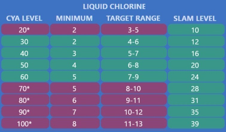

That’s correct. You want to be as far away from any return jet or skimmer / suction port.
If they are on opposite sides of the pool, go to the middle between them. And 12-18” is correct:
I’ll encourage you to read Pool Care Basics, which is apart of Pool School. Also get the PoolMath app and use it.
As Jim mentioned, 10 ppm FC is just fine for CYA of 50. Slightly above the “target range”, but fine as you’ll lose that FC to UV quickly.
