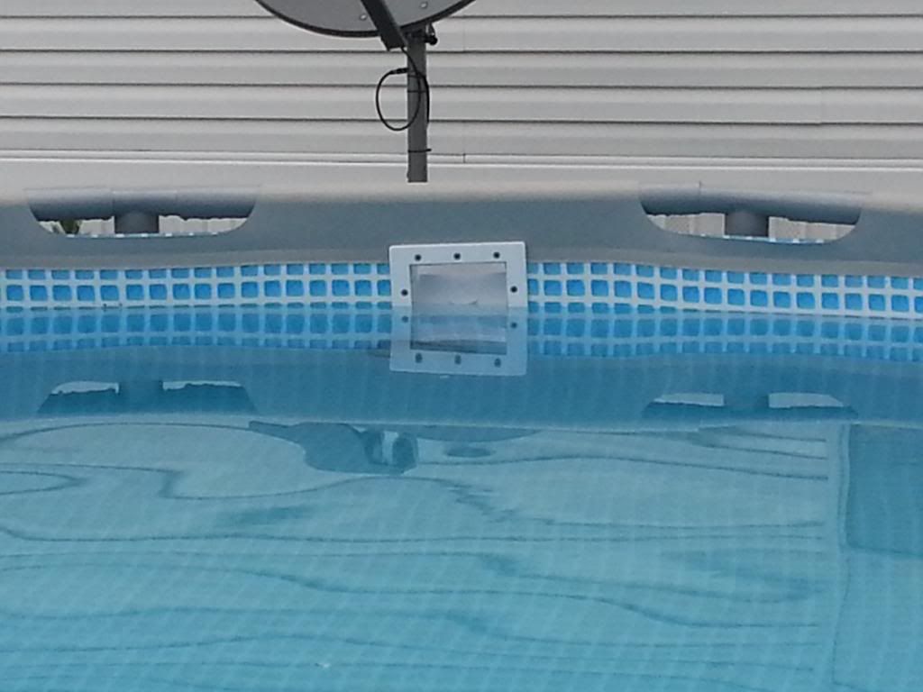

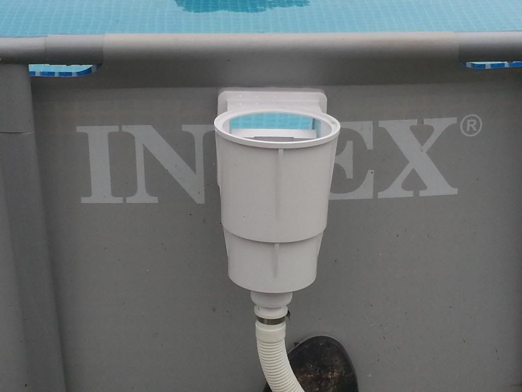

just to put anyones mind at ease on the butterfly gasket, cutting it in two is VERY simple. it took me about 2 minutes with an exacto knife, and as far as the install went, was perhaps the easiest step.
Either install method listed in this thread will work just fine, I just wanted to dispel any notion that cutting the gasket is any big deal.... cause it aint. :D
I was originally going to cut it as most of what I had read stated that's how it was done. I realized it's simply unnecessary. Only thing it would do is make a simple install easier. If it were designed that way it would have came 2 piece. But as stated, either method works.
Anyone having concerns about this mod need not worry.
