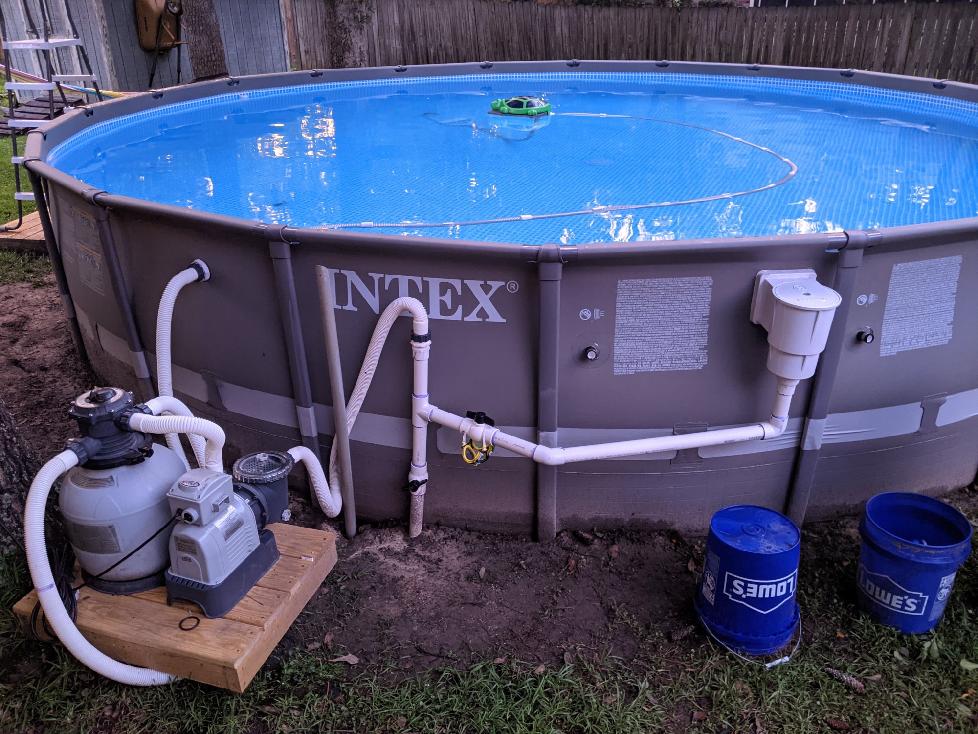

I did this exact thing over the winter. Moved the equipment to a new pad, away from pool using 1 1/2” Sch 40 PVC. I bought Praher brand unions and Jandy valves from Inyopools. The IMG_1599.jpegIMG_1607.jpeghave one side of the union which is threaded - a lot easier to pipe up and saves make up distance between fittings.
Check your pump installation information. Most require a certain number of pipe diameters from the pump before fitting or valves. Mine was 5 pipe diameters, so with 1 1/2” = 7 1/2”.
Here are some pics of the transformation.
