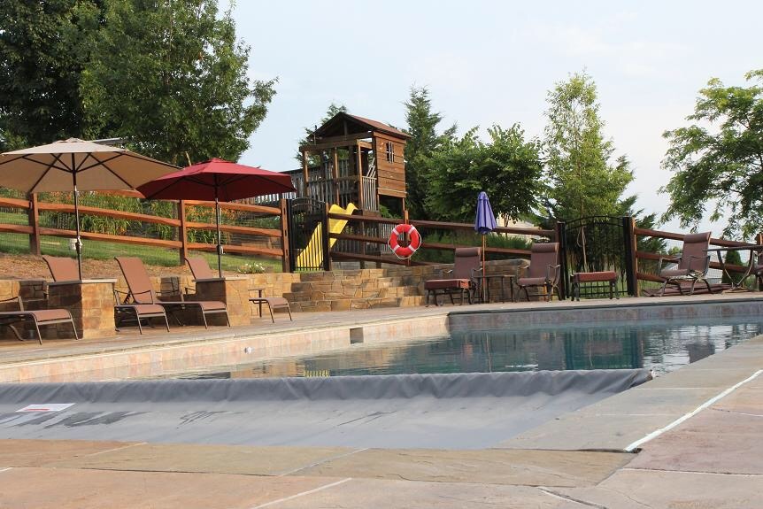

After much discussion, my wife and I have decided to go with a 20x40 rectangle and an auto cover. We are also very much interested in putting an auto cover on our raised hot tub. While this isn't the sexiest design, we have seen some very nice examples of this setup online and feel like the benefits of the auto cover outweigh the limitations in design.
Does anyone have any good reason not to use a black cover? We feel it would look best with the color scheme of hour house. We will have the Hayward fully automated system with sense and dispense, etc.
Hmmmmm... I chose blue so that it was obviously a pool. I worried that in the dark a gray cover wouldn't stand out as obviously from the gray deck and worried someone would just walk over it......
In your area black *might* help heat the water up a bit more even than my blue cover does. That would be a welcome reason to me if I were in PA.
Maddie :flower:
My only thoughts about black are heat, but in PA, that’s not really that bad. And dirt. I think it will show dirt/stains easily. But the big picture look is really the main factor. We went with grey and like it.
We have a home that has a lot of black accents. Windows, gutters, roofing, etc. I think the black cover would be in keeping with that theme. Heat would be a secondary benefit and I do get your point about the dirt. Grey would be our second choice.
