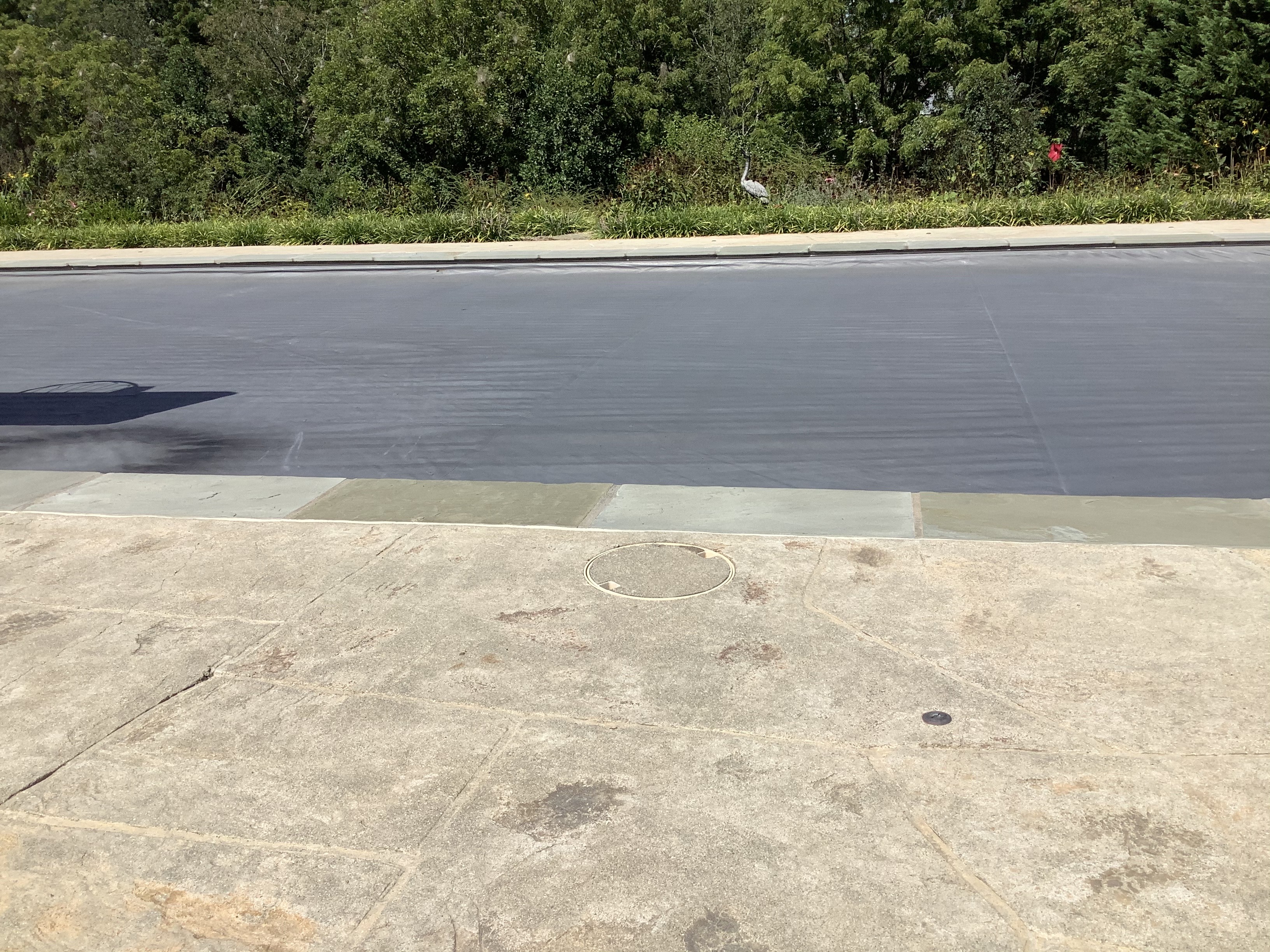

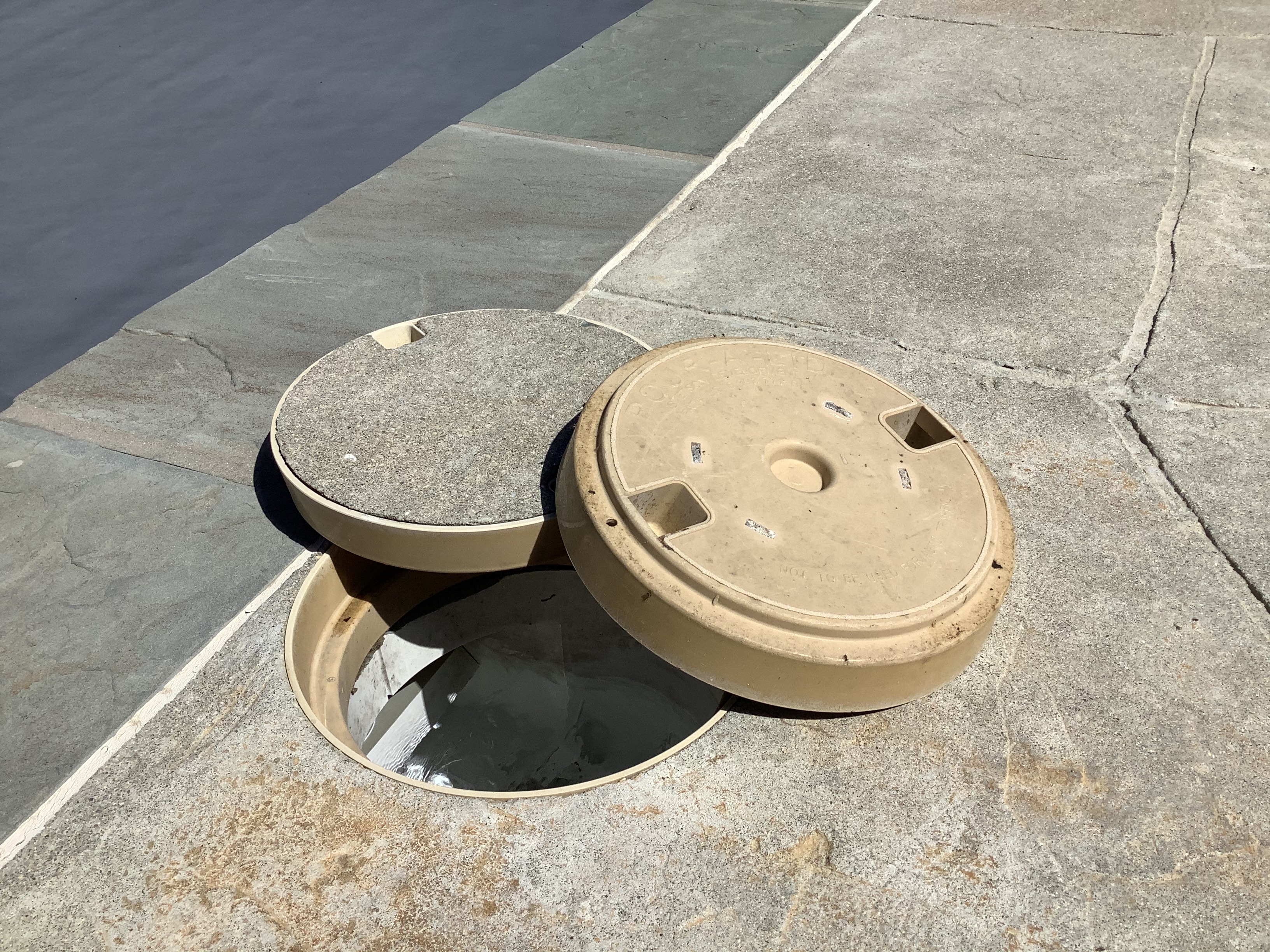

Small thing but big on appearance. Get Pour-a-lid skimmer covers. They need to be ordered and available during construction. Your concrete and spray coating goes in the lid to make it all but invisible from any distance. You just see a round circle about 1/4” wide of plastic instead of a 10” circle of white plastic. And order it in the color closest to your spray coating. Probably the tan color I have. They can be used with any skimmer as the collar just sits inside of the lip of the skimmer.
