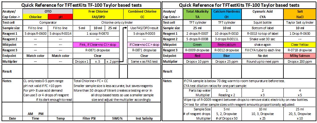

OK.. all in one post.. all my chem testing tid-bits... First here is the TF100 reference card I made.. yes I use it, I made it. Is this blatant self promotion?, heck yeah. ;) If anything I no longer glance at the other instructions and "fill the 25 ml vial" to 25 ml, when I am supposed to be filling to 10ml.
Here's a link to the thread with the PDF version of it for you:

one more vote for the reference card, I use it all the time and I have it laminated . thanks
