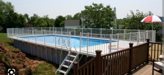

Hey McCreatc and Welcome !!! Got any pics ? I'm pretty sure I know what you're talking about and they were popular by me back in the day.
I think kayak is a cousin/sister of yours that looks like this : (or somewhat similar)

I will send some better pictures tomorrow as its night time here now. The pool is 20 x 40 and here is a picture. Yes, the installer has done these before and will add concrete at the bottom, I am concerned that it wont be high enough to keep the walls from pushing out. It was a Fanta-Sea pool, but I removed the solar panels and put decking on top. I did put additional bracing on the plywood that makes up the wall of the pool.

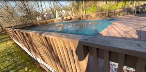

This is what it looked like before I removed the solar panels from the inside perimeter of the pool.

If you look in the middle of the pool, you will see a section that is dug into the ground. The walls are 4 feet at the shallow end and made of plywood and sits on the ground, the deep part is about another 4 feet dug in the ground. The steel walls would sit below the deck on the ground backfilled by concrete at the base.
