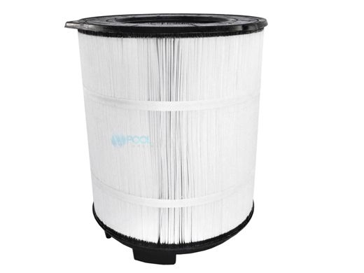

That's what I found for new ones. Both these are the big one and link to the little one further down the page. It's not the worst thing because ever because they'll last another 10 years, and that's better than $1700 (?) on a new filter.
Your model # shows up on my filters (500s) the arrow points to the middle # (mine), and yours is the bottom #.
Pretty sure all 3 fit the same housing and these are a good deal cheaper in non shortages times.
Fat one :
Skinny one :
