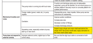

My Pentair VSP is 6 years old and recently started making a squeaky sound, see video. I’ve done zero maintenance on the pump since I got it. It works flawlessly.
I’m assuming some part needs lubricating, but I’m unsure. Does anyone have a guess as to what the problem could be and a potential fix (assuming anything needs to be done)?

Normally is the fan shroud on the back of the motor.

Maybe the pump shaft seal or the motor shaft seal.

Done, changed link to YouTube. If it is the fan shroud what do I do? Is this high/low priority? Any other possibilities as to what it could be?
Check what JamesW posted -- though it sounds like it is a constant sound not just at start or stop.
Fan shroud has screws. See if one or some are loose.
Not urgent if fan shroud, if seals as posted by JamesW, I would get that worked on.
Reactions: Obecalp86

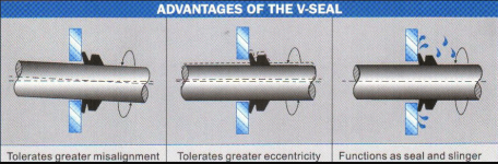

There is a flat rubber washer called a water slinger and behind the flat rubber washer is a motor shaft seal that looks like the below rubber seal.
Replace the pump shaft seal, the motor shaft seal and the water slinger.
You can remove the slinger and motor shaft seal as they are not critical, but you risk motor damage from dirt, debris and water possibly getting into the motor and bearings.
There is a gap at the bottom of the motor where you could use spray silicone to try to lubricate the Motor Shaft Seal.
