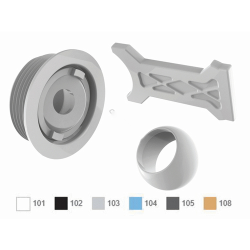

Ok, so I located a spa eyeball that appears to be sucking dye back in. I have included a picture below. Do they make a tool that I can use to remove/replace the fitting? Could it be as simple as changing that jet?

N,
They do make a tool to remove the eye ball.
The jet is located further back in the gunite.
Having water flow backwards is not that odd if one or more of the other jets is clogged.
Is the water flowing backwards when the pump is off???
Jim R.

That looks alot like mine which is an eyeball only, no jet. It's just a standard tee with an air loop. If yours is like that ot could still be anywhere
The eyeball comes out with that ring removed, but the fitting has to be chipped out. They are all on a equalizing loop, so finding the one is issue if indeed where water going. To isolate mine, once verified water was going out via return plumbing, the leak tech inserted an inflatable balloon plug down each fitting pipe until test pressure loss stopped. Though the general area was known, this isolated which jet and where exactly in its plumbing.
