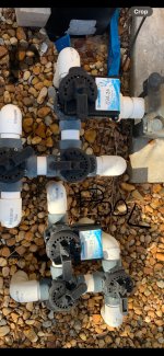

So after around 30 min of running the pump in spa mode I’ve lost around 2 inches see below

I would check that your return diverter is not leaking some water back to the pool in SPA mode.
The one circled the gasket was replaced recently. That’s the electrical one.
The one with the arrow does that need to be moved every time
I use the spa ?
