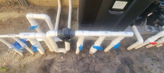

It's the red valve labeled pool main drain. When I turned it to the closed position, the water stays up, but when I put it in the open position and the pump isn't on the water goes down.

The water is siphoning from your Spa Drain to the Pool Main Drain.

I think the 3way valve for the POOL/SPA suction is not completely closed on the SPA side and allowing water to siphon through it.
Adjust that valve or it may have been damaged during installation and is leaking.

I agree with Allen, that the only way that shutting off the pool's main drain could effect the spa draining down, would be that your Intake valve is leaking.
That said, we do not see that too often, so it would be worth running a few tests just to make sure.
Since you have no automation system, it would be important to know exactly what positions the valves are in when you shut off the pump.
The most likely cause for the spa to drain down would be the fact that there is no check valve on the Spa-T-Jet line. But.. That would not be the case, if the Jandy valve on that line was always set to 'OFF" when the pump is turned off.

AC,
In your pics the Spa Return is shut off (or almost shut off) and that line has a check valve.
With the blue Spa Return valve shut off, I assume the spa still drains. :scratch:
If so, and you know for sure that that turning off the pool main drain stops the drain down, then it has to be the Intake valve. You can prove this by putting a plug in the spa drain as a test.
