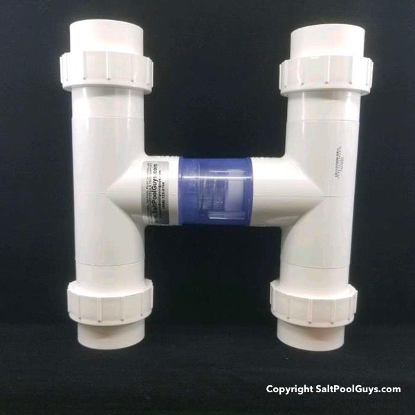

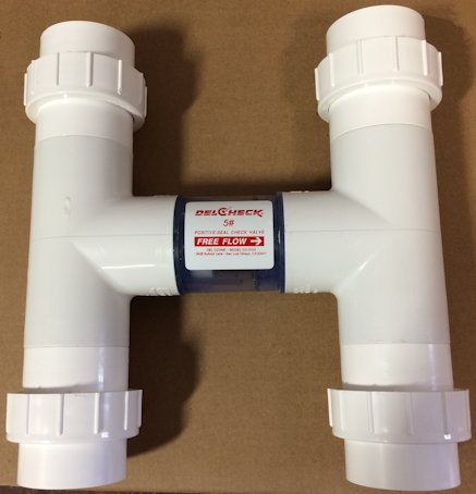

This bypass valve will automatically adjust the flow through the Heat Pump when it exceeds the maximum flow rate…
But how do I overcome the flow issue? A VS pump on low to circulate and filter, then turn it up to boost jets? Wouldn't this throw the flow rate through the heater out of spec? This is the problem I'm trying to overcome?
Some Heat Pumps have an internal bypass that will automatically regulate the maximum flow through the heat exchanger so that it is not eroded from high flow.
If you HP you get does not have an internal bypass you can install an external bypass like his...
