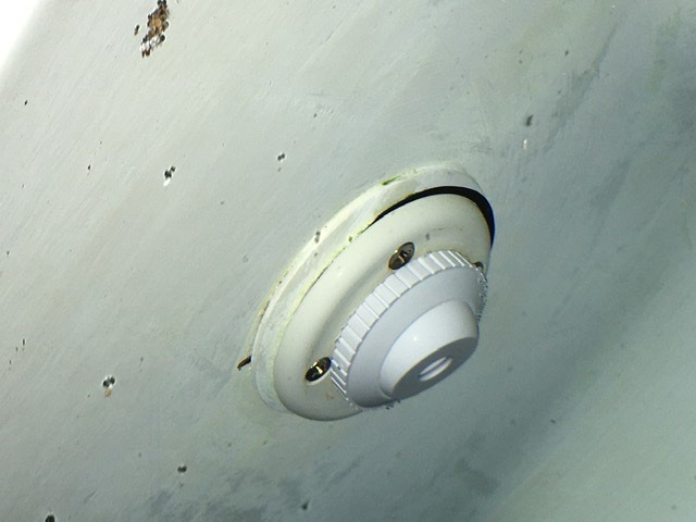

It's a venturi step jet.
The tube should provide air.
The eyeball is too small and it is forcing water out of the tube instead of pulling in air.
The eyeball looks brand new.
When was the eyeball installed?
Remove the eyeball or get a larger diameter orifice.
Below, you can see the original orifice size.
I think that the original orifice was 1".
The existing one looks like 1/2".
Once again, I’ll say how awesome y’all are! That’s the eyeball that was there when I bought the house. I have a 3/4” in the shed so I’ll put that in. I’ll have to order a new cap. The puppy chewed a chunk out of the cap so it won’t stay on at this point. It never leaked before before she chewed it and there’s never been any kind of “bubble” function that I’ve seen but I’m sure that’s because I had no clue what this thing was. At least it’s an easy fix!
