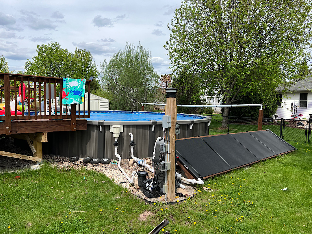

I’ve been really pleased with this panel for my pool:
FAFCO Super Solar Bear Above Ground Pool Heating System with Installation Kit 10061
Amazon.com
I live in east-central Wisconsin, where we’re not exactly known for our warmth, and I’ve had my pool as warm as 92 this Summer.
Here’s a pic where you can see the ground rack I built for them:
Reactions: proavia and Newdude
