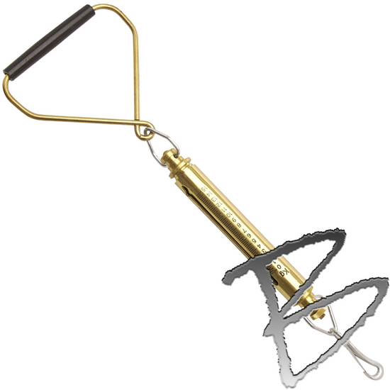

If you have a good steel tape (one made for surveying). It has two corrections built into it - temperature and tension. There is a spring loaded grip you use to provide the proper tension to the tape that the tape is calibrated for. You measure the ambient temperature of the air, and apply a measurement correction based on the expansion of contraction of the steel tape. You can get accuracy to 0.01 feet this way, about 1/8" inch.
Haven't see that sort of thing done in decades - not since the price of lasers and total stations came down enough to offset saved labor and accuracy. When I had to take a course on it in college, it was already considered old school, and we learned both that way (Steel tapes and optical theodolites), and with electronic total stations.
