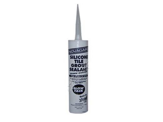

I would suggest looking at NovaGard or NovaFlex silicone adhesive/grout.
It is interesting that the Novagard site points to these products...
I have used the NovaGard silicone grout in the past for some repairs. Now looking at removing all the grout (cement based) from our water line tile and replacing with NovaFlex. It comes in many colors versus the NovaGard.
Any suggestions on where to buy this stuff online? All of the distributors near me carry their roof stuff, but not the marine stuff. The only options on Novagard's site is a whole case.
