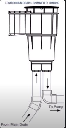

For the big question - the skimmer. Post a pic of your equipment pad. It depends on how your pool was plumbed. You either have a main drain that is plumbed to that front-facing skimmer hole, then both the drain and skimmer water gets pulled into the rear hole towards the equipment pad ... OR .... Your drain and skimmer are plumbed independently to the pad. That would mean the installer only had a 2-hole skimmer and just plugged one port. But the rear hole (towards the pad) of the skimmer is usually the one that pulls water and should be free & clear.

If you have valves marked as Main Drain and Skimmer, then your Main drain is not plumbed into the bottom of the skimmer..
When the main drain is not plumbed to the skimmer the extra hole is normally capped off. Normally, the hole closest to the water is capped and the other hole is plumbed to the pump.. but, if you have suction at either hole, that is the hole that is connected to the main pool pump.
