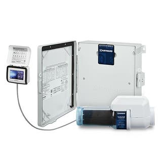

So, I ordered this:
AquaRite S3 Omni Salt System 40,000 gallon​
FEATURES​
Features:
• LCD color display for built-in control of chlorine levels, heater and variable-speed pump (single-speed pump control via Smart Relay, HLH485RELAY, sold separately)
• Works only with a genuine S3 Series Hayward salt cell
• Clear TurboCell salt cell for easy inspection
• Operates over a broad range of salt levels,800-8000 ppm
• Pool cover detect capabilities
• Auto voltage select for easier installation
• Easy upgrade path to Omni® controls via AQRS3OMNIKIT, AquaRite S3 Omni Features
•Includes all AquaRite S3 features above
• Full control of virtually any pool or spa feature via the external control panel, OmniLogic® app or voice control devices*
• Valve ports to automatically switch to Spa mode, GVA-24 automatic actuators sold separately
• ColorLogic lighting control with OmniDirect Mode™
• pH and ORP sensing capabilities, probes sold separately
• Expand at any time with easy-to-add accessories from smart relays, pH sensing, WiFi connectivity and more
• Configurable for future upgrades, Control and set schedules for 3x variable-speed pumps, Control 2x heaters, 2 high power relays
• Capable of controlling an acid feed tank, *Voice control devices are not included.
Looks like I can order 2 actuators and control my pool and spa valves with this system and I don't need the more expensive OmniPL.
