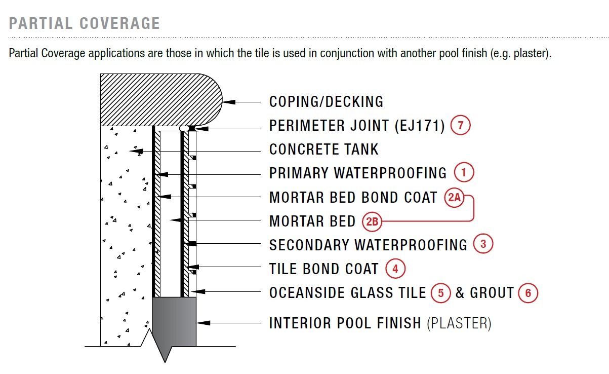

I almost 100% guarantee the tile / spillover was not done correctly as most companies have no idea how to do it right.. And that sure looks like glass tile.. That brings the below requirements.. I bet they did your tile in 1 or 2 days and no waterproofing was done..
I have uploaded the OGT document that these directions came off of, most glass tile companies have these instructions that must be followed..

If there is a leak in the pipe behind the wall then it will have to be all ripped out, the pipe fixed and then all put back together.. Preferably correctly done this time..
