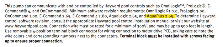

If that is the case, you will need to use a new Hayward pump for it to communicate directly. Or, you can buy the 1.85 variable speed motor and Hayward drive, put them on your existing wet end and have a Hayward VSP. That would save about $200 from the cost of a new Hayward W3SP3202VSP, a 1.85thp VSP. Its not a hard project. Don't forget to get a communication cable (they come with a new pump, usually).
Or, you could go the V-Green 1.65 route, save even more money and get very similar results (pump performance would be the same). Putting the V-Green on the wet end is easier, especially when trying to mount the drive on a Hayward motor. It especially takes patience with the drive mounting screws that MUST be completely tightened against the motor for a proper ground. Its not hard, but you must be patient so that they don't break off (ask me how I know).

Before you purchase a pump, look into your pumps menu in the configuration menu. If there is not an option for a variable speed pump it won't communicate with a Hayward, or any other, VSP directly. If you seriously want to use your Goldline (Hayward) system you can look for the highly elusive OmniPL upgrade kit (they just were released). Right now, if you can get one, they are about $12-$1300. Then, you would have to buy a Hayward VSP. Good pumps, had mine without problem for about 12 years.
Your system will operate a V-Green 165. I've done it with 2 Hayward systems, but several Jandy. They all work about the same. You can use it to set a start time, allow the internal timer to go through its programming (whatever you set) and then stop. You can leave that relay "on" forever (or put the wires from the Load terminals of relay 1 to the Line side) and the motor will do its program every 24 hours. That is the simplest but gives you no control through the automation.
