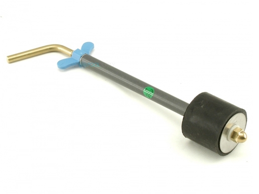

Go to Anderson Mfr. They have good plugs that ca either be screwed in our will go the depth you need into the PVC pipe to really get a good grip. Here is just one example. They have many more.
