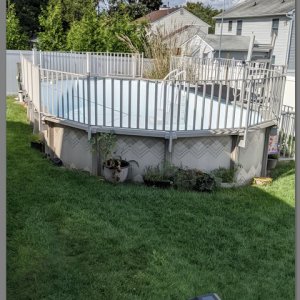

Our AGP sadly needs to come down. We changed to a saltwater system years ago and now everything is rusted to the point that we can’t remove the rails to change the liner. Due to a winter leak, more than half the water is gone, and our yard is so muddy we can’t walk in it – and we have 3 large dogs. I’m concerned it will cave in before long. Any guidance on how to do a very rusty teardown safely, links (Google is getting me nowhere), and ideas for the perfectly level 15X30 oval (other than doggie sandbox) would be greatly appreciated!
