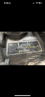

Put this pump model number in your signature...
