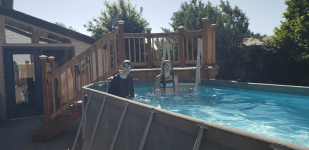

Interesting, I had not thought of that. That would probably be the western end. Which is also the end with deck and stairs. Found a pic of the old pool.
Thinking maybe the panel behind my son. The factory intakes and returns will be on the right hand side.
New return eyeball left-hand side? Would be diagonal from the factory return but kind of across from the factory intakes.
