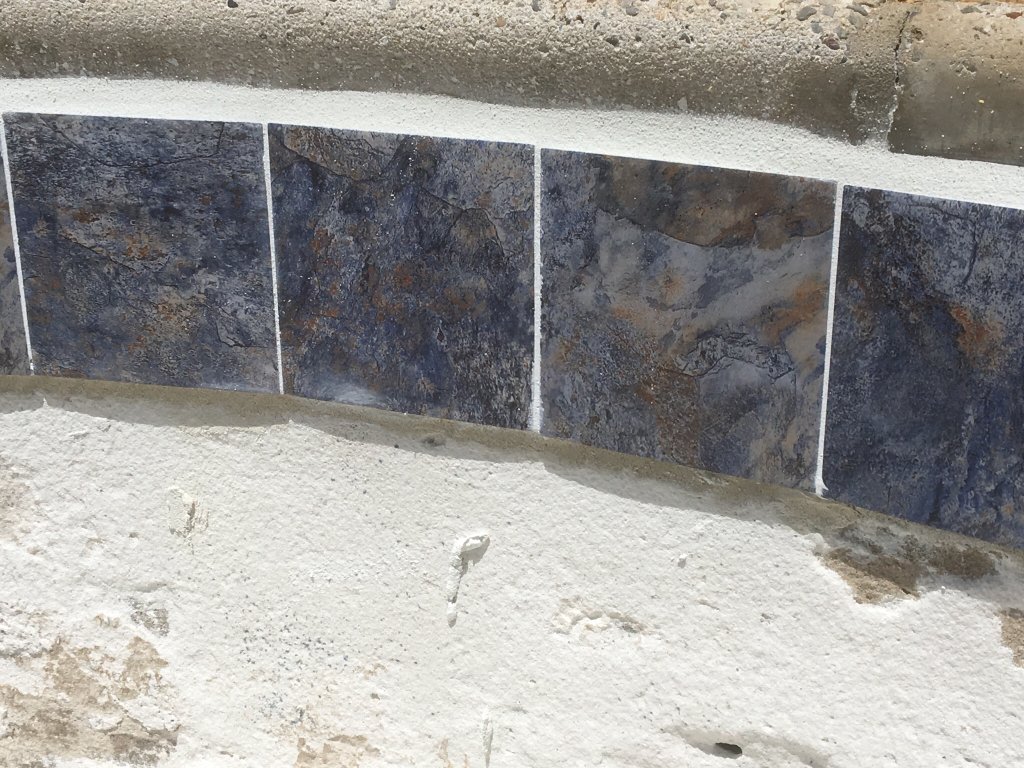

I initially selected their "stock" tile and finally received an email with their samples. I'm not impressed. Let me know your thoughts.
I've got ME21 in my pool built in '05. Difficult keeping them looking that nice. Getting the whole pool replastered next summer and this is one thing I'm thinking of changing out.

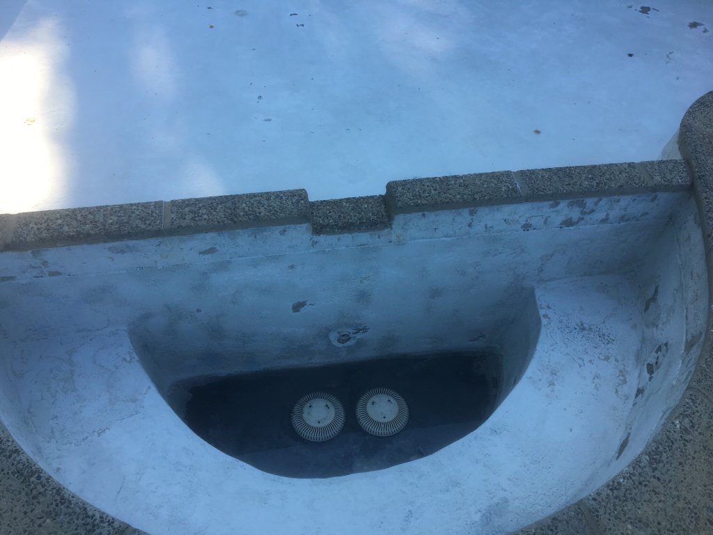

Sandblast completed. They didn't do a very thorough job on the spa. Not sure if that is okay. I can still see some blue paint in the deep crevices. They left a mess in the deep end which I guess the plaster guys will clean up.

The lip on the coping is pretty bad due to slab settling, in that spa photo. Since our pools are pretty much the same and your a few miles down the road, of course I had the same problem....lol! I had a company come out about 6 years ago to do concrete jacking (inject concrete in little holes to lift it). Worked pretty good. I know you're not going to be here for long, but thought I would mention it. At this point you should check the gap between the plastic overflow and the concrete to make sure there's no cracks or gaps for water to seep into.
Thanks for letting me know. If you don't mind me asking, how much was it and what company did you use? You can inbox me if you don't want to post it in the forum.
Might as well post here. It was A-1 Concrete Leveling. Think it was around $2k, but every job is different. Really, if your spending much more then that then you should probably apply that to a new patio. The holes aren't that noticeable once the fresh concrete ages a bit. They can't promise the slab will stay lifted forever, but they have good prices to come back and make tweeks after a few years.
Oh man, I love the tile! It looks fabulous - great selection!! I'm so bad at visualizing something, but you nailed it. Those guys did a beautiful job. You can tell that's What They Do!!!
Just having the new tile already makes things look newer and more modern!
