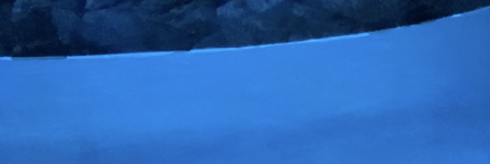

they did not do a full chip out throughout the entire pool though they did most of the spa - just not enough. i asked if they could extend the pipes or use elbows or something like that and they said no. I place at lot of blame of the guy doing the tear out but more on the sloppy plaster job - $32k - I'm sick. Tonight we tried our pool light and there is a weird choppy florescent light at the edge of the water and our rock wall - could this be chemicals? The waters edge and the rock never had this - it was a smooth transition - I'm baffled

they did find the leaks - around 2 of the lowest jets in the spa - I am concerned that this will be a future problem - we had leaks in the spa years ago and they were patched and re-plastered (not even close in color) which is why we re-did it all - the spa leaks caused our spa area to sink and had to have a company come out to raise the area - I just don't know what to do - what I should expect - they had the entire history of our pool and the under lying issues
I have a BIG sad for you....................me? I would insist on a FULL chip out of the spa and start all over with it. Even if the plaster is a bit different than the pool no one will notice. Even if they do they could think you meant to do it.
Reactions: JeanneEisen
I am sorry but I do not understand what your current problem is.
Much of your posts describe past problems.
as Kimkats said - a full chip out of the spa is needed - the owner is coming out this week - if they would phave explained the pipes were low and the new layer of plaster will encroach I would have demanded the seat of the spa be chipped down to granite so i didn't loose another 2-3 inches of height for my jets . If only I new then what Ie know now.
