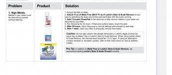

I been going to Leslie’s for all my pool test. I actually think you’re right. Some how during the first few weeks the high copper readings were missed. With my cooper levels around 0.7ppm do you recommend this treatment? I will attach a picture below. Is a treatment for high metals.

the High metal treatment that I posted earlier was Leslie’s recommendation for my high copper level “0.7”

Well, that is nice that Leslies says that. To be honest, this forum does not accept pool store testing for any guidance nor believe the majority of pool stores have the pool owners best interest in mind.
The best way to attempt to remove copper stains (not necessarily always successful) is to use Jack's Magic Blue Stuff and then dump the pool water for fresh.
