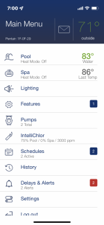

We will need screenshots from your ScreenLogic.

You are correct with the schedule. I played around with it today and changed it to 9:30 PM. But yesterday it was set for 8 AM – 8 PM and continued to run the entire night and didn’t shut off.
Brand new pool. And the build to me was a disaster and I don’t have confidence that they really know what they’re doing. The Pebble Tec guy told me about this forum and said it be worth it to go on here.
The pump that read the RPM is set for the water features. The one that had the display is for the pool. But both are supposed to be set up for the automation system.
Screenshots requested are below.

In your last screenshots, it does not appear that the automation knows the pumps are running.
