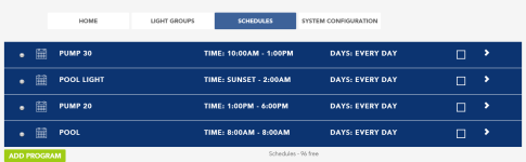

So, I got the Intelliflo3 installed, and moving from the single speed to the VSF has caused my to question my setup. I have the VSF wired directly to the CBs and moved my SWG from the AUX relay that I jumped back to load side of the Filter Pump relay. Data cables are correct as well. What has me scratching my head is why I loose temp readings, and I get a no flow alert from the Intellichlor when the pump schedule ends.
Now, maybe to answer my own question, I think I figured out that the Pool Circuit needs to be on all the time? When I turn it on, I get my salt cell reading back as well as my temps. Do my settings look correct to you guys? I shouldn't have any lights on the ic40 with just the Pool Circuit active... correct?

So, no... that can't be correct. When I just turn on "Pool" it energizes the Filter Pump relay... No pump but I get alternating red and green, no flow, and % leds on the SWG.
I guess I figured the VSF data would turn off the Filter Pump relay when it was not running, but that is not the case. I changed the timer for the Pool circuit to 10A to 6P to match the feature circuits for speed.
I didn't realize the Pool circuit schedule was still set to the default 8A to 8P before this last change... that is why I was getting the alerts from the IC40. I think I am beginning to understand the logic behind the system... a little...

The Pump/Filter relay will only close if you are in the Pool or Spa modes.. Period!!
Pump, 20, 30 and 50 do NOT close the Pump/Filter relay.
The best approach is to have the Pool Circuit on for the entire time you want the pump to run for any reason.

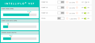

Only potential problems:
1 - I'm running the SWG at 40% now for 8 hours. If I run it 24, then I need to cut it back?
2 - Keeping proper flow through the SWG... that's one of the reasons I use GPM vs RPM.
3 - I know I have a flow problem, I need to replace the cells in my DE filter, going to do that this weekend.
4 - Other flow problem, skimmer and main drain lines are 1.5" and the line to three returns, filter and heater are 2".
Sample flow rates according to the VSF:

8r,
Just to be clear.. My cell's flow switch closes at about 1100 RPM, so I add 100 RPM, just to make sure..
That is pretty much what we recommend. SWCG's flow switch close RPM, plus 100 or so RPM. (Or GPM, whatever works for you.)
At 1200 RPM, your pump used 108 Watts.. At 1200 RPM my pump uses just under 200 Watts. This is because all my IntelliFlo pumps are over 10 years old.. All the newer pumps are even more efficient. From that point of view you have a much better IntelliFlo than I have...
I always say I can run my pump 24/7 for less than $20 bucks a month.. But I say that because not everyone has low cost electrical rates, so I use $20 bucks.. It is really about $12 bucks a month to run 24/7.. But I have no heater so I can run at a lower RPM and still close my flow switch.. If I had a heater, I'd most likely have to run at 1500 to 1700 RPM..
Yes.. you will have to adjust your SWCG's output down, to match your increased run time.
The size of the plumbing lines does not have a lot to do with the flow at low RPMs.. Most problems with pipe sizes is when you are trying to run at max speed for some reason.
