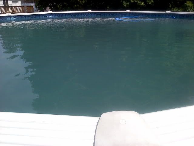

The pool this morning. Still murky, but starting to look more like a real pool - an aqua blue!
I just went and bought 12 jumbo bottles of bleach. My vacation budget took a hit.

Well, it was 96 and SUPER sunny here today. We got down pretty low on the FC count I think. Still above 5, but much less than the 10+ we'd been maintaining. Just wasn't home to keep an eye on it.
That said, the water clarity now is MUCH better than even the photo I posted earlier. It's still not clear, but it's turning a beautiful color. I almost wish we weren't leaving tomorrow so I could see it turn clear!
