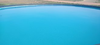

I added an algaecide yesterday along with adding manual chlorine. Haven't done a test yet but we are a lot more clear now, I have a TF100xl test kit coming that I ordered this am. When it gets here, I will post the results for the pool as well as our actual water and keep you guys updated. I will also try to see about getting borates to add as well. Thank you guys for the massive help so far, your help has kept us from solely ditching the SWG. I look forward to the continued help!!IMG_20210711_084834.jpg

algaecide and is that a floater I see?, possible CYA over 100...suggest you load up on liquid chlorine, get those tabs out of your pool, and stop buying magic potions until you really know what you need. one thing for sure you are going to need is liquid chlorine and possibly a partial drain. don't put anything else into your water until you know what is going on. liquid chlorine ONLY, for now.

Wasn't a floater at all. Just a moth that fell in and was spinning in circles trying to get out. We also don't use chlorine tabs either.. we use powdered chlorine and that's currently all we are using until my tf 100 comes in.. I think the algae is a problem though because chlorine tanks at night.. as for liquid chlorine we decided not to go that route because of not being able to store it for long.. a month of storage just isn't practical IMHO.. we are using the shock treatment at 5 ounces to get proper chlorine levels in the am. We turned off the swg until we could figure out what was going on.. on here there was a post talking about the liquid chlorine only being able to be stored for a month before it starts to weaken, that is correct right?

H, the floater you are thinking of is our skimmer. I thought you were talking about water bugs, we get those as well here and there.. boatmen is I think what I saw when I read up on them
