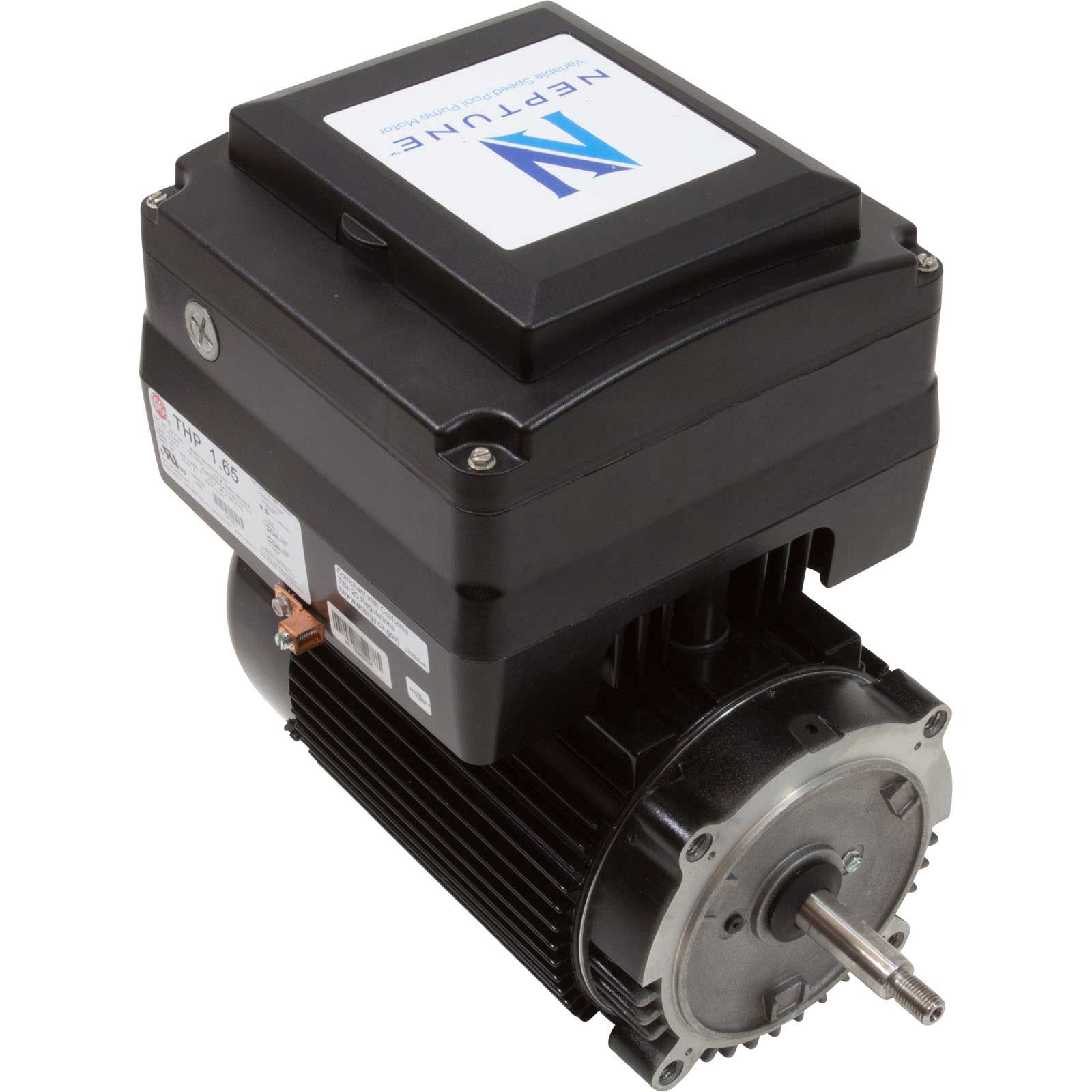

Looks like single speed. A VSP motor, if you have a good pump, might be an option.
Either of these with a Go-Kit 2.
@1poolman1 can confirm the gokit...

If you have pentair automation, then look at the pentair intelliflo3. You really need to stay in the same family (automation / Pump / cell). There are other options, but they are a pain. (sorry I missed automation in your signature). With the intelliflo, you can control the pump.
You could also go with what I gave you, connect power to the current easy touch, leave it 'On'. When you turn it on, turn on the the pump. I would program the pump to run the same speed for 24 hours, low speed and forget about it. Mine is about 200W, or $20 per month.

This sounds like the way. I have no need for anything fancy. The pentair automation just enabled me to save some money running a single speed part of the day and if necessary switch valves around for an attached spa that i don't use because the heater is busted. I don't have fancy waterfalls or anything either. I can be happy with 24/7 power on at a lower speed setting. If the motor allows me to configure it directly like this one does I'll be happy. The price is right - the century V.O. is only about $100 than i spent last summer to replace a blown out single-speed. I hope it comes pre-wired for 220v so it's easy peasy and a matching capacitor but i'll have some 250 VACs on hand if not.
It's dual voltage. Wire the pump directly to the breaker, don't use the easy touch.
They are both dual voltage. You won't need any caps.
Not pre-wired...i.e. there is no pigtail, you will have to wire from the easytouch breaker.
