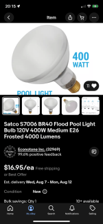

Searching Google for R-40 120 volt 400 watt pool bulb returns a large number of options.
What, from those options, has you concerned? What are you looking for in a bulb, specifically...?
Nothing in particular. Just asking the forum to see if there was a favorite or one to stay away from.
This ok?

Haven't seen much. The incandescents are like regular bulbs...hit or miss on quality...it is an incandescent...
The only recommendation for LED I've seen is the J&J Purewhite 2, depending on the fixture.
