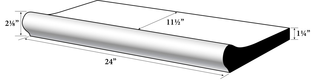

7. Coping length. The white limestone coping I was shown was like 24 inches long. Whereas the other options seems to be smaller, like pavers. The one I was shown was like this:1706292755147.jpeg
If I go with pavers for deck and patio, this one makes sense. But if I go with a concrete deck, would those be a bad choice? I like the length of the limestone ones but it seems like it only comes in white and I am not sure i like that or maybe im not used to it. I think it only comes in white because I want the one with the bull nose. I think its this one from npt :
Anything else that is 24" long would be greater than 1.5" in heigh, which would be to tall to replace my existing one.

7. Coping length. The white limestone coping I was shown was like 24 inches long. Whereas the other options seems to be smaller, like pavers. The one I was shown was like this:View attachment 551646
