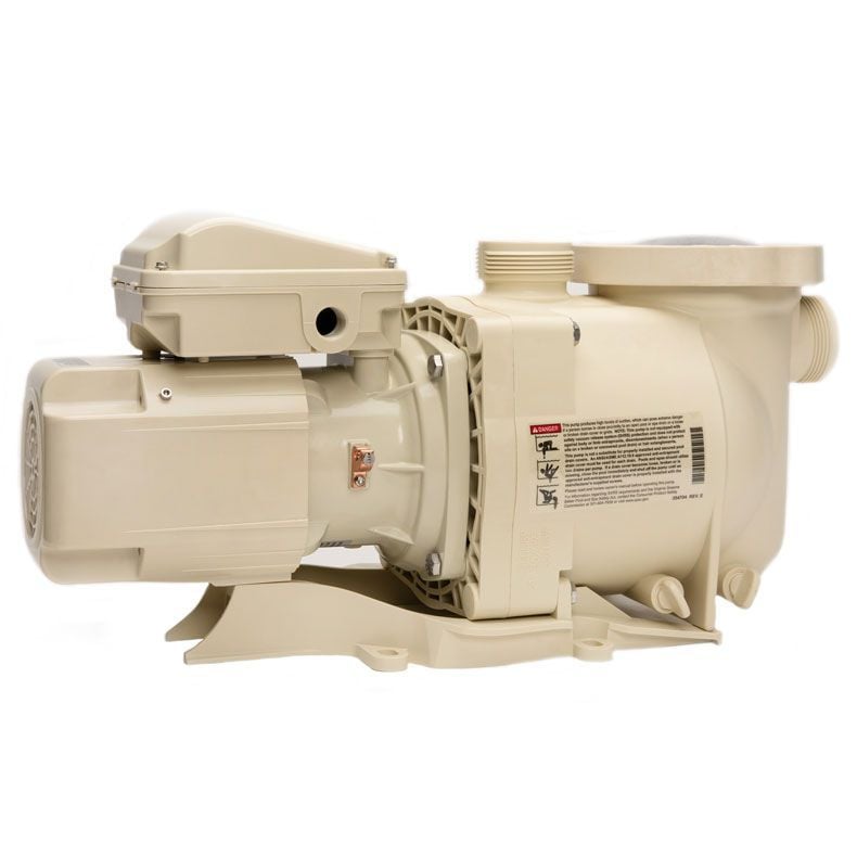

Doheny's 2-Speed Pool Pump, 230V, 1 HP - Doheny's Pool Supplies Fast
Doheny's 2-Speed Pool Pump, 230V, 1 HP. Hurry and purchase today at Doheny's Pool Supplies Fast
Pentair SuperFlo Pool Pump, 115/230V, 1 HP
Pentair SuperFlo Pool Pump, 115/230V, 1 HP. Hurry and purchase today at Doheny's Pool Supplies Fast
