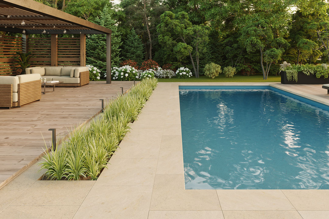

Less than 25 miles away is a manufacturing facility for Del Conca which has a nice 2 cm porcelain product Del Conca outdoor patio pool deck
that is also available through NPT.
