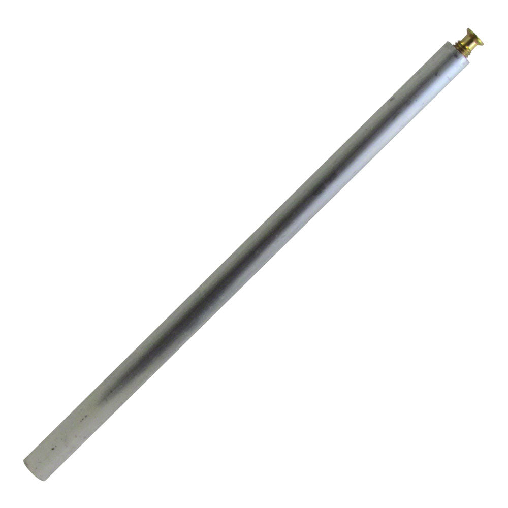

Something like these.
Note: Examples only, not a recommendation for the seller.
Oh thank you!! Knowing the right search terms is a huge help!

All of the safety cover makers sell standard paver tubes, so I don't know why anyone would make their own.
In any case, the anchor in the pipe will be a slightly bigger diameter and you will have to drill a bigger hole to get the pipes in.
The regular brass anchors are 3/4” and the pipes are 15/16” or 1”.
