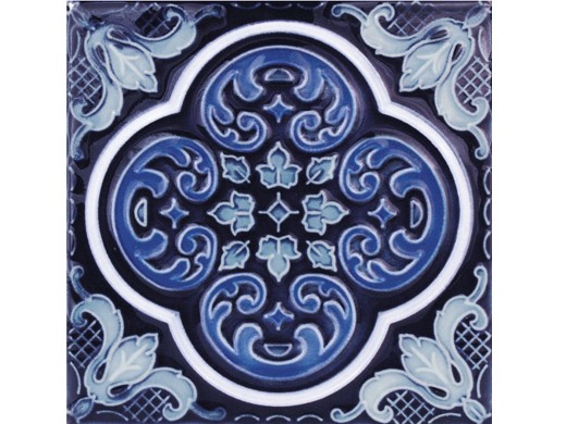

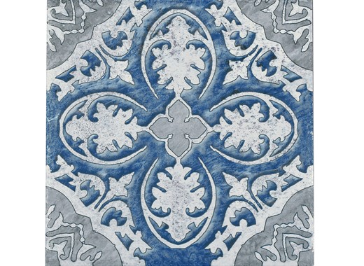

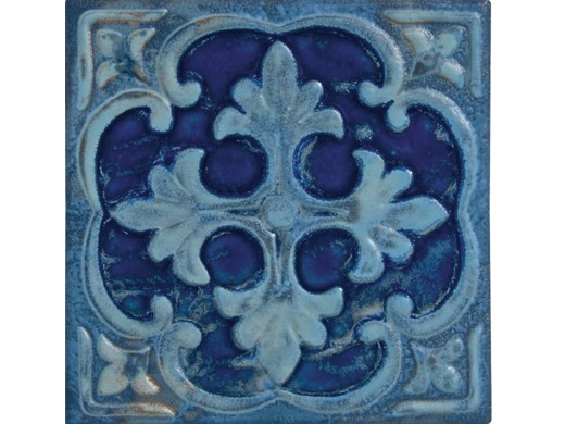

So here are some of my ideas for ceramic tile:
I LOVE this one. I bet there will be some very pretty ones in the boxes!
OH look at this one!
This one is very interesting. I am thinking of cutting it so it is only one line
Like this one also!
Okay so these next three think about this-the extra pretty tile will be an accent tile..............Note the first one has some "plain" colored ones to the side of it. So for every 3 to 5 plain tiles you will have a of the accent tiles!
Thoughts? You cannot hurt my feelings. Tell me what you like and what you don't like and why....we can go from there!
