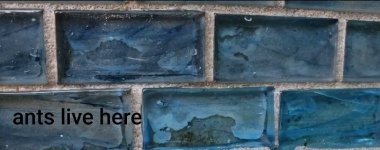

Here are pictures of the wall with the tile that's coming down. There are crooked tiles, uneven spacing between tile sections, not leveled (sticking away from wall) and trowel marks so bad I can see ants crawling behind the tile. They attempted to spot repair, but that left mismatched grout. It continues to get worse, especially the areas below the water with trowel gaps. Water has gotten trapped in areas behind the tile and they are discoloring from behind. Simply a poor installation overall so now the whole thing is coming down. The tile was a front faced installation since it was transparent tile. I understand there is a larger degree of difficulty to that type of installation, but this installation was also rushed and time was not taken to do it the right way.
The tiles on the steps are fine. They were hand installed one by one by a different member of the crew and since they are set prior to plaster and are in the plaster, those are staying put. This is the reason I'm looking for a new tile that's not a front faced installation and not transparent, but will match closely to the tile staying on the steps.
