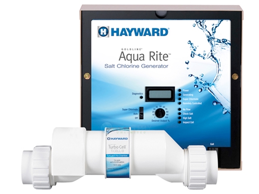

Just talked to the PB and he said it would be $2300 to upgrade to the saltwater system, I asked what system that would be and he said it was Hayward Aquarite 25,000 gallon system. I am guessing it is this one? Either way seems like he is way over charging, so I will likely just install it myself when the pool is finished.
