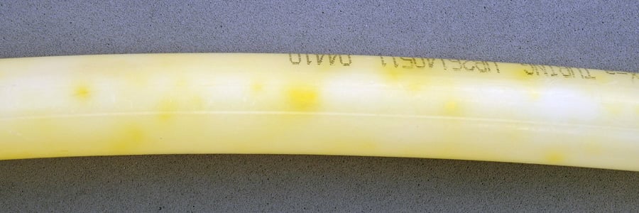

Frequent or continuous exposure to water conditions beyond those used in ASTM Test Method F2023 (i.e., aggressive water quality with an ORP above 825 mV and/or pressures above 80 psig and/or temperatures above 140°F) may cause premature oxidation and eventual brittleness of the PEX material, reducing its ability to meet long-term requirements. Conversely, infrequent or sporadic exposure to such operating conditions may have little effect on PEX pipe or tubing, with regards to its anticipated lifetime.
For operating conditions beyond the specified end-use conditions of the respective PEX standards, users should contact the specific pipe or tubing manufacturer to determine whether such conditions are approved for use.
Lab testing revealed that the failures of the PEX were consistent with chlorine degradation. Chlorine degradation of PEX occurs when the chlorine in drinking water, which is added to keep it clean and safe for human consumption, attacks the PEX piping, breaking down molecular bonds, resulting in micro-cracks that gradually expand to the point of a pipe failure. Because of this, PEX piping includes chlorine-neutralizing chemicals that are intended to extend the life of the pipe.
While PEX is tested for resistance to chlorine, there are several factors that increase the risk of chlorine failures in PEX, including elevated temperatures and pressures, exposure to UV rays from the sun or fluorescent lights, and local water conditions.
PEX is susceptible to oxidative degradation and embrittlement when exposed to hot chlorinated water, while CPVC isn’t susceptible to attack by chlorinated water.
