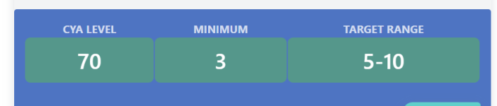

Copy both. Maybe I am reading the CYA chart wrong? I thought CYA 60 is a bit low. At least that's how I read the "red" vs "green" recommended levels.
It is for typical SWG pools. I have always run a 70, north of you, and am going to experiment with 80 once the summer is in full swing.
You may find 60 holds the FC just fine. That's great if so. If not you can bump it.
