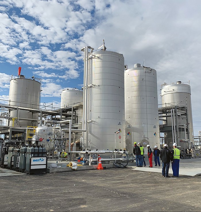

I think that it is mainly wastewater being treated vs. people's tap water.
How peracetic acid is changing wastewater treatment
There was a program by the City of Tucson water supplier to create potable water from runoff and waste water supplies. The created a pilot process at one of their facilities to demonstrate the feasibility and they marketed it to the public giving it the tag line - “From the toilet to the Tap!!” - and they wondered why it failed spectacularly with the public 😂
