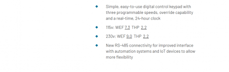

I am attempting to automate a Pentair SuperFlo VST pump (342002) that is connected to a spa. The installation manual says that the pump has an RS-485 port, but it looks like the wrong number of pins. The Pentiar RS-485 communications cable (350122) that I ordered will not fit.
I believe that Pentairs RS-485 port has 7 pins, but this pump's port (pictured below) has 8. Any idea what cable is needed to connect that to an IntelliCenter?
