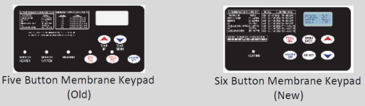

While running, press and hold the On button to display the exhaust temperature (Older Models).
The new models use the Menu to get the SFS.
Here is what the normal exhaust temperature should be:
  • Below 250 degrees...very low
  • 250 to 290 ..................low
  • 290 to 350.................acceptable
  • 350 to 480 ..................high
  • Above 480...................error/shutdown.
Note: HD models can be up to 75 degrees higher. HD models use a cupro nickel exchanger and the efficiency is slightly lower resulting in less heat transfer and more waste heat.

Also, I did check the SFS and it was at 325. I have not had a chance to check the gas usage.
That is in the acceptable range, so the heater is probably working at the correct capacity.
Check it periodically.
The heat losses are probably pretty high.
