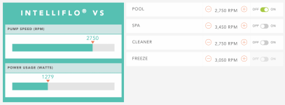

I would also like to see the pump speeds that are assigned to each circuit in the IntelliCenter.
When the pump is running, do you see the RPM and wattage on the IntelliCenter?

During normal hour operation the display does say "Display not Active". Also per your ask, here are a few screenshots showing various circuits and pump speeds and when the pump is running with RPM and wattage in a few different modes.
From everything I can see, the pump is working as expected.
It is a complete mystery to me as to why the VS pump just "looses" comuunication after 8pm but then regains it the next morning for normal behavior per the automation schedule. Also, during the day, adhoc actions like turning the Spa on/off, waterfall on/off, etc. work without issue.
